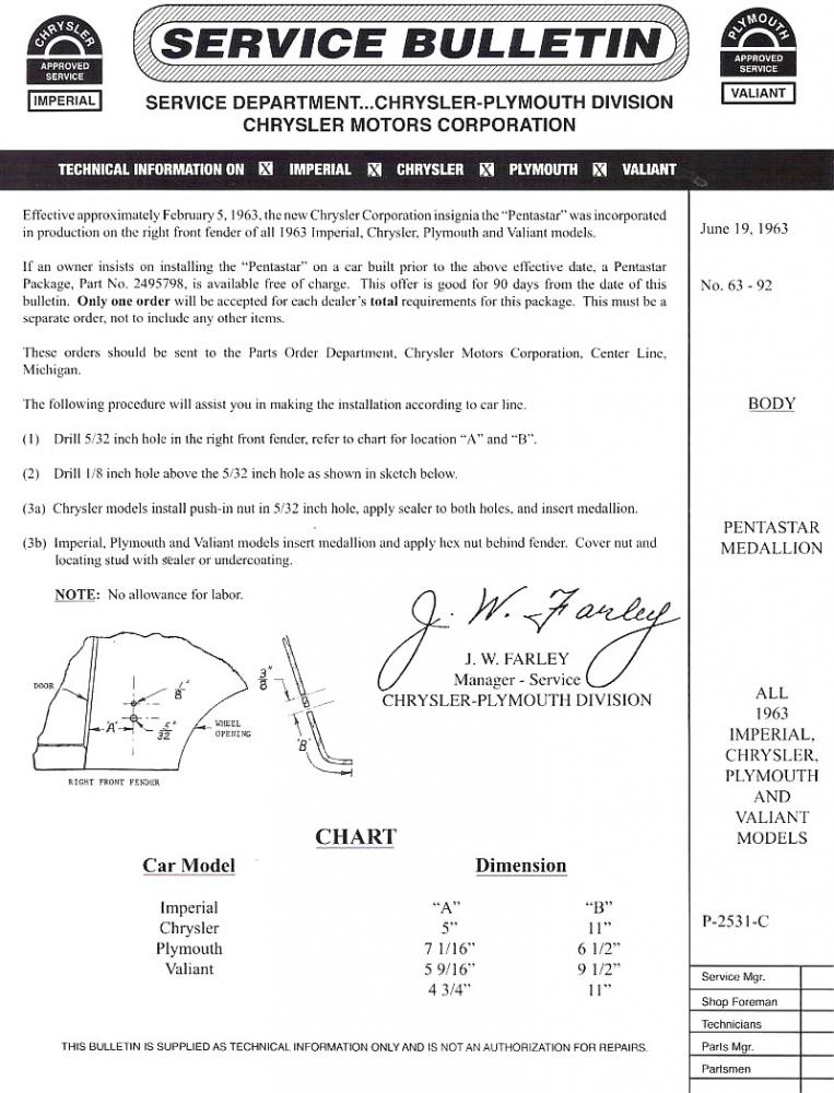

1963 tsb
Thanks ODZKing. I think the question of Pentastar location has been asked before (in reference to re-popped fenders).
