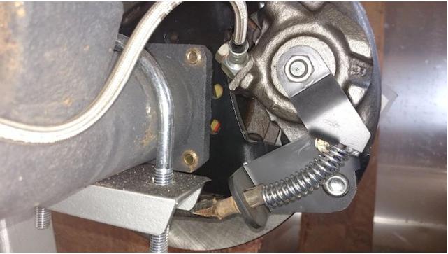

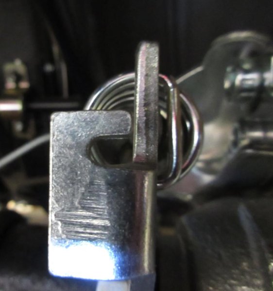

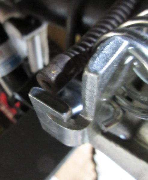

It looks like the emergency brake cable ought to hook onto this tab, but the cable is ever so slightly too short -
And it looks like the clip and outer cable should be a couple inches further down the line -
Is there a way to adjust the existing cables, or do I need to have new ones made? If I need to have new ones made, who makes them?
Incidentally, it seems like the springs on these calipers were installed on the wrong sides. I had to swap them to get a clear path for the cable to get to the tab where it should hook up.

Looks like the springs on his are installed as mine originally were. I need a pic of the emergency brake cable installed correctly in the caliper.
I would call or email scarebird. I used their front brake kit aprox 3 yrs ago.
I had a couple questions and they were happy to help out.
Here's another video on adjusting the parking brake -
It seems like this was/is a popular caliper for affordable disc brake conversions. GM used it on Eldorado/Riviera/Toronado (maybe others?) so they made a ton of them. It may not belong on a race car but I bet it's perfectly fine for the street.
