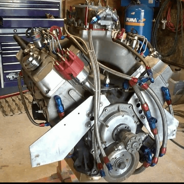

Already have a Milodon gear drive and was wondering if I could use an Enderle pump on a max effort 600+ n/a 383?
has an electric water pump
I can pick one up pretty cheap at swaps around me.
E85 build but may set up for gas in the future.
Haven't decided on a carb setup yet, probably dual 660 Holley's or a single Dominator.
Found this pic on the web, so it could be done?
Dg1G-aFR1K7tkhkBwHuRr2oEbW8jPPYHSuS9_Y1qExJjxsu7XQlDihizhKf7RNpYLj91XPtM=w947-h948-no?authuser=0.png
Am I crazy for thinking of this?
Not Crazy, but No, it won't work! That pump is designed to put out alot of volume.
A Blown dragster burns anywhere from four to six gallons of fuel in the quarter,
You'll be lucky to need a quart! Looks like someone took the blower off of that
engine and set a manifold and carb on it for a photo-op.
That's what I thought. Thanks for the reality check
