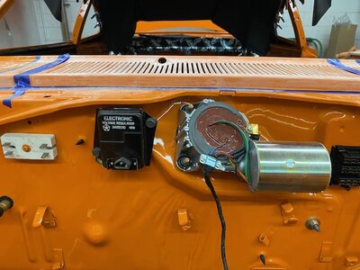

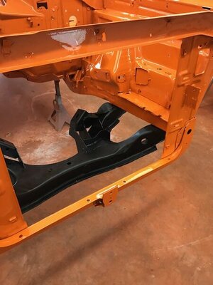

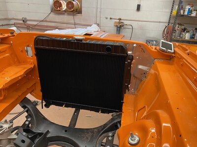

After almost 30 years,(yes have owned it a long time.) I've finally decided to paint my engine bay body color. It's been flat black since I got the car. What parts of the bay get color? Does the K-frame get body color? Do the rails that the K-frame attaches to? I'm going to try and detail all of the under hood components too like the blower motor, wiper motor. The engine will be out so I can really accesses every corner of the bay. I'm not doing a restoration, but want it to look a bit more original and finished.
1973 Charger, '71 Ram Charger Hood, painted sublime green
Body color is every part welded to the car. Plus the body panels: hood, hinges, latch bracket, fenders, valence. Also the hood catch, the round rod bolted to the bottom front of the hood.
The hood latch, spring, levers, secondary latch are not body color.
Hope this helps.

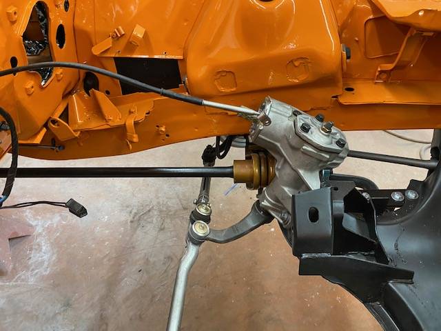

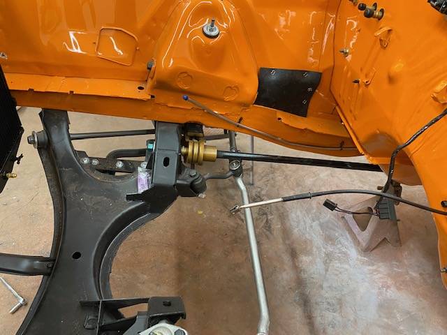

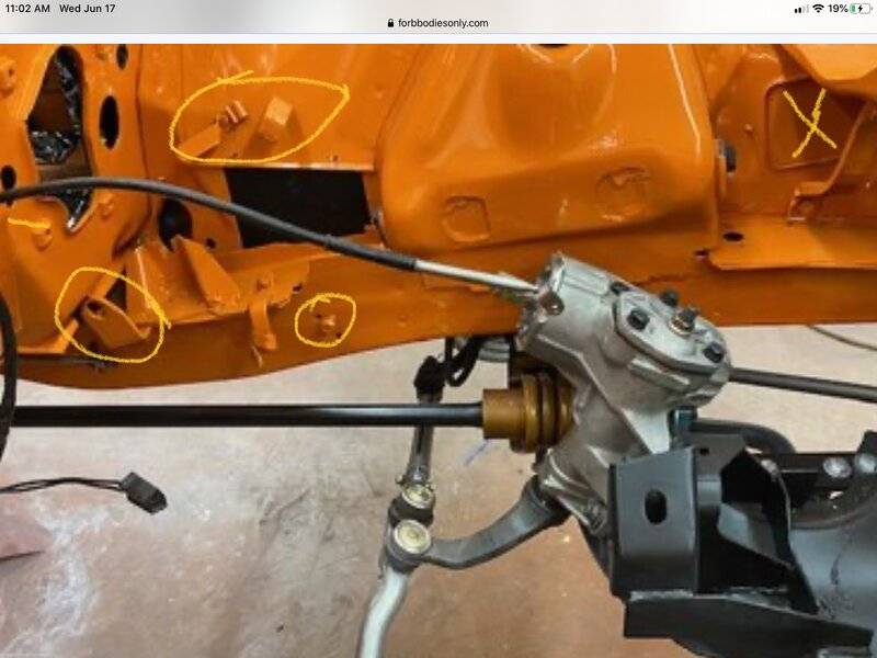

No, the small cover to access the front upper control arm adjustment nut/stud. I had a 74 RR and I remember mine being painted black (car was red).
You have several things painted that should not be painted.
2 wire looms on driver lower rear inner fender well
Bolt for brake valve
Linkage bracket
2 metal covers for alignment in front of shock tower each side
Linkage bracket
I have replaced the wire looms with new pieces since painted, but what color was the linkage bracket (Natural)??
I want to say that linkage bracket should be neutral but I don't have any proof...
