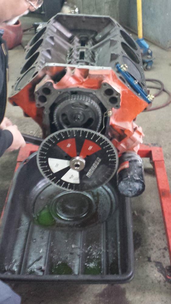

Still waiting on the rockers and pushrods from Comp Cams, did get the cam installed and set today, repainted the block, installed the oil pick up from Milodon and reinstalled the distributor.

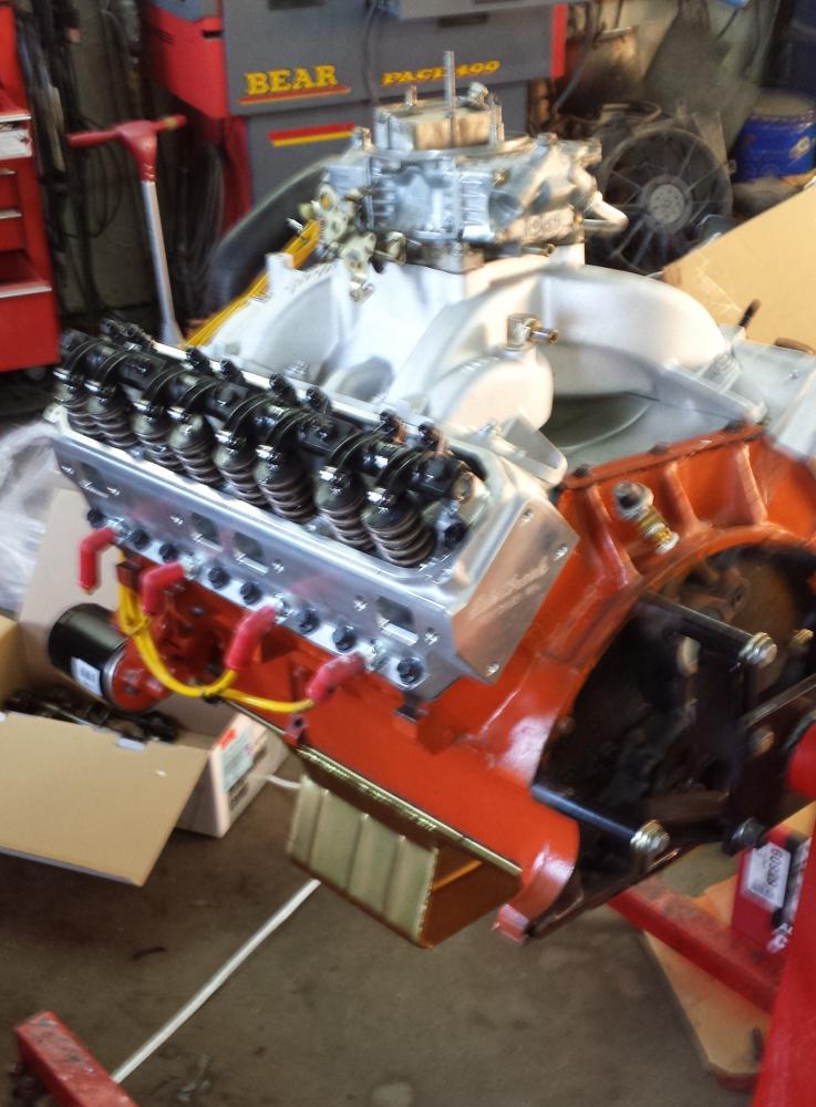

We ordered what was reccomended by the Edelbrock kit and with the adjustable roller rockers they will work just fine. My mechanic went thru 10 revolutions for each side checking the opening and closing of the valves as I watched. I think we will hear it run tomorrow, for sure Tuesday. I am anxious to hear the .545 lift cam bring this puppy to life. My Mechanic has a 4.89( 1/8)drag car and said the Comp Cam rockers and pushrods were soem of the best he had ever seen and would probably switch next time he built an engine.
