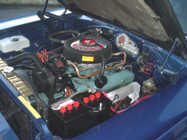

So I was thinking that the correct engine color for my 68 GTX 440 was the turquoise, but then read this:
The engine I have is the OE from a 69 GTX 440 HP and it was painted orange. So what color did they paint the 68 440 HP GTX motor? Was it the orange as the 69 had and as the chart above references or did it come with the turquoise in 1968? According to the above it matters if the engine was an HP or not and I thought 68 GTX would have been considered a HP 440 (orange) and I'm thinking it should be blue. :/ Thoughts?
The 68 GTX is a HP 440 and the correct engine color is turquoise - I’ve had mine for 46 years. I painted it Hemi orange on this last rebuild because I like that color better. But if you ant to be correct it’s turquoise.
good stuff, I think we are all on the same page with colors either turquoise or orange I guess it comes down to whether the 68 'X 440 was/is/or considered a HP motor? again I though the 'X had a HP motor, but to my belief it was turquoise.
Below are not my words, but the info I beleive to be correct. Note, 1968 HP440-Hemi Orange. But I do not own and never have owned an original 1968 440 car.
Source: http://www.turbinecar.com/misc/enginecolor.htm

Oh how I wish that list could be banned from the web.....there are so many inaccuracies it causes more problems than its worth.
No. No. The list is crap.
68 GTX 440 is turquoise.
Definitely conflicting info out there regarding 68/69 colors. I do have an original 68 X down the road which I will likely conform that the '8 'X was turquoise
OK, I'll delete it then...........
Well don't do that...take it with a grain of salt. Do note the mopar ad for paint also called the engine in question hemi orange at least once also.
The 68 GTX allcame with the 375 hp motor which is the upgrade HP motor over the standard 440 used in motor homes, luxury cars etc. Paint color as stated was turquoise. I bought mine a couple years old and it was and always has been turquoise until I recently painted it orange. I’ve never seen a correct 440 from that year that wasn’t painted turquoise. The six barrel 440 came along in 69 and had 390 horse. That was painted orange. Maybe all the 69’s were painted orange - I can’t speak for that. Can only speak for the 68 with assurance.
67 and 68 440 HPs were turquoise.
69 and 70 440 HPs were orange.
