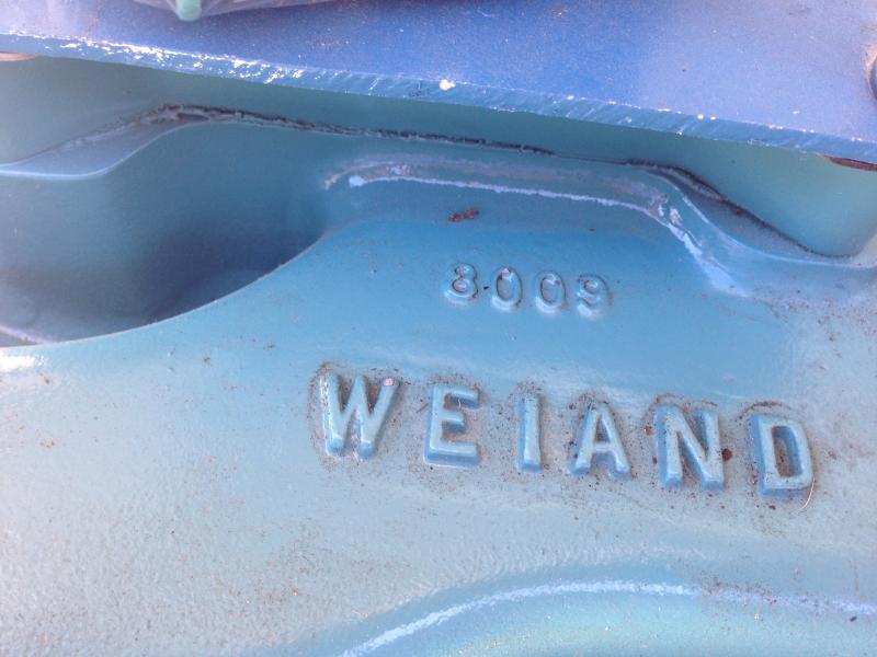

engine color
If it is an HP, orange I believe
Correct color for 1966 Dodge/Plymouth 440
Turquoise is correct for ALL big blocks in 1966 (except the orange Hemi).
Corporate Blue didn't show up on a big block until 1972, when that color was universal across the board in cars.
