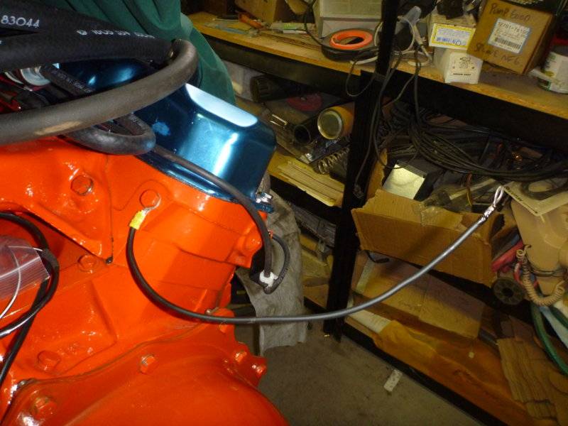

Engine ground strap. 69 Road runner
If it helps any, the one on my 66 Charger is a 10 Gauge.
Believe I made mine out of 12 gauge, might have been 10. Heavier than anything in that bulkhead connector...
Classic Industries sells a ground strap for a 68-9 RR. Part #MD2571.
Does not indicate gauge, sorry.
mine is the same as Dadsbee's
Only I used shrink wrapped and soldered connections as opposed to crimped ends
We tried to make everything look factory even when it wasn't

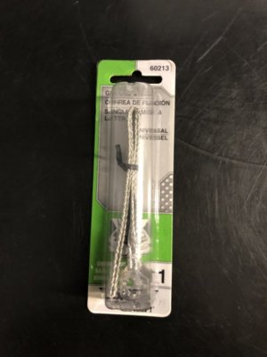

From AZ, Dorman #60213, 15" long; at least a 10ga.
