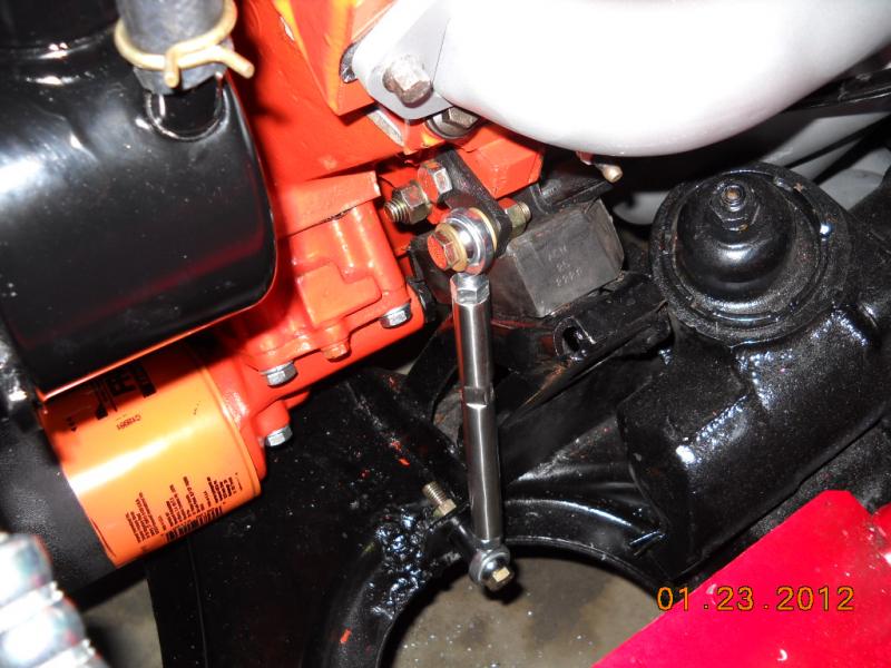

Another solution: A March adjustable rod from Summit. I think it was around $40.00. I won't take credit for that beautiful (????) weld. The tab was on the car when I bought it.

C'mon Dave, dont be bashfull, lol!!

I knew that if I didn't say something someone else would............lol.
