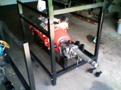

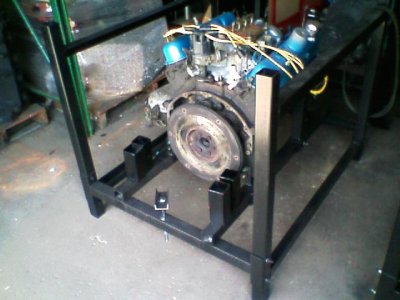

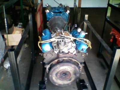

our company makes these and here is what we do with our engines mostly to get them off the floor and so we can stack them. We made these stands for ourselves. you could use them as a run stand if you add your radiator and you would have to use manifolds because headers hit the angle iron bottom pieces.engine stand 1.jpgengine stand 2.jpgengine stand 3.jpg
