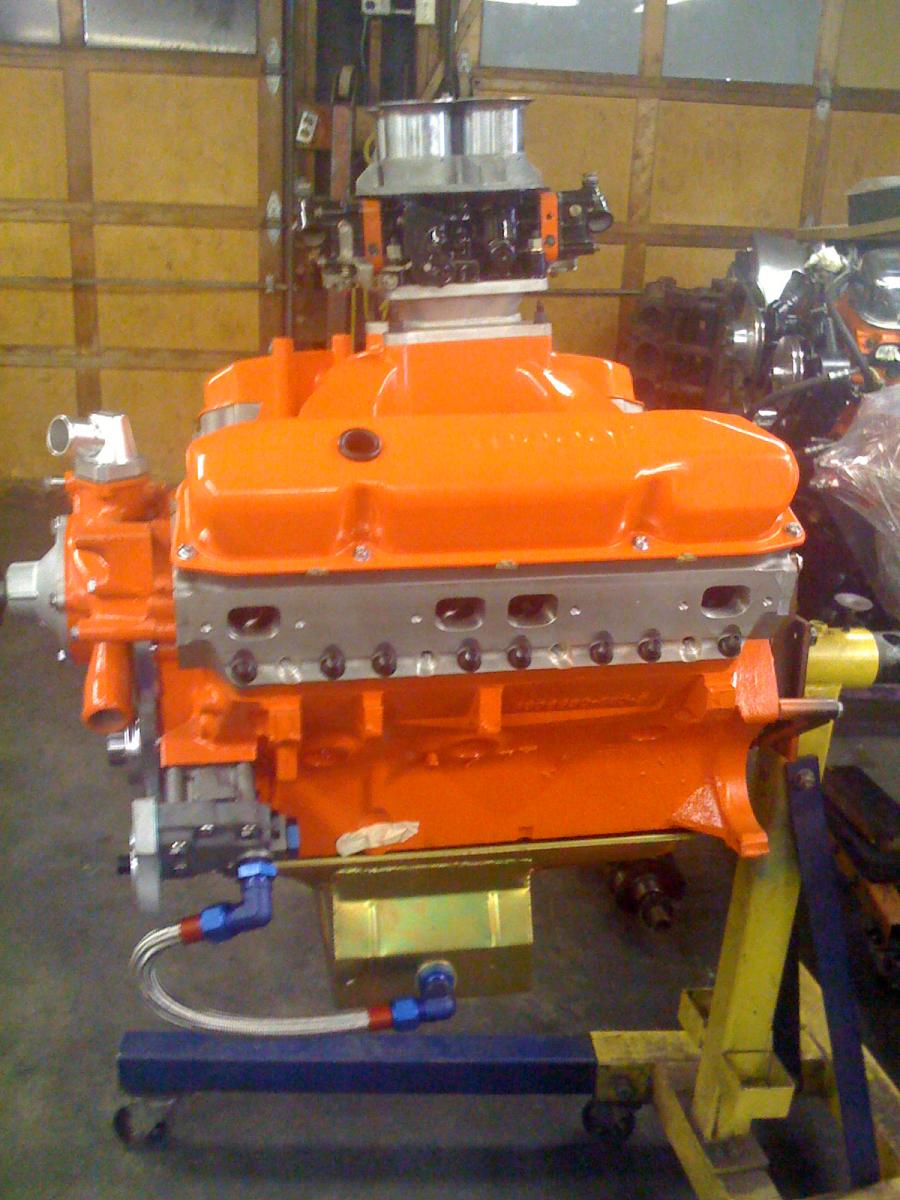

dont be scared. your k member will work. Just find a 4 door bb donor car and get buzy. If you drop another small block in you,ll forever be saying what if? you know you want one.
If that don't get you drooling nothing will!!
Don't you just hate that :rolling::rolling:
