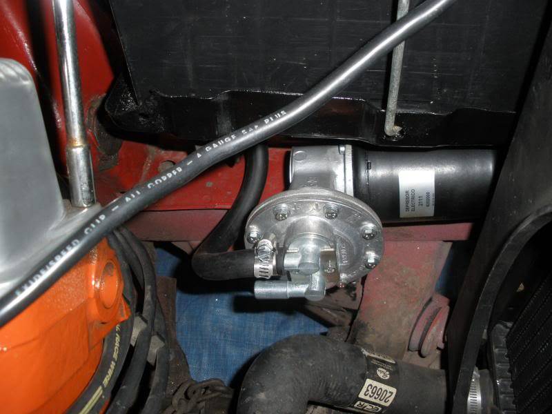

Where the heck should I mount it?
Well the Cruze pump has pressure but no volume. When I bought the car the guy gave me a SSBC pump and preesure switch kit. This is the kit http://www.summitracing.com/parts/ssb-28146
The Cruze pump will not turn off with the pressure switch but the big ssbc pump will build up pressure and shut off.
I'm going to have to run the SSBC pump.
Problem is I've tried to find a place to mount it but it's a 68 Charger with the vacuum canister for the hideaways under the battery tray and no other room except where the MSD box is right front inner fender.
I can't move the MSD box anyplace else without a goofy looking bracket.
In front of the core support wont work due to the headlight actuators.
Thinking about in the wheel well but really don't fit there either with turning radius and bumps to consider.
Anyone running this pump with a great place to mount it please let me know.
Thanks
Mike Z.
