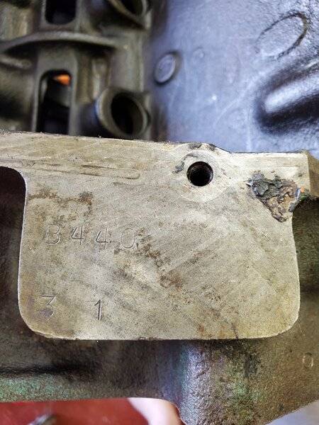

Putting the crank back in after polishing the journals and used plastigage to check clearances. Everything looked ok except for the #1 main. Looked at the old bearing and compared and didn't notice any visual anomalies. Went ahead and lightly scraped and crocus clothed the #1 main bearing a couple times until the plastigage read within normal. Strange. The markings indicated the shells were the same as the rest. I took another look at the pad and under the B 440 there is a 3 and a 1. Does this mean anything?
March 1st 1966 machining date is what the 3 1 means on a B 440

Yeah, date code for assembly/machining. I used the search function after I asked the question. The plastigage method was in the literature I am using. I did use a digital caliper initially on the journals bit not the bore gauge. The crank is now as smooth as butter after my intervention. I suppose time will be the test of my machining abilities. Thanks
