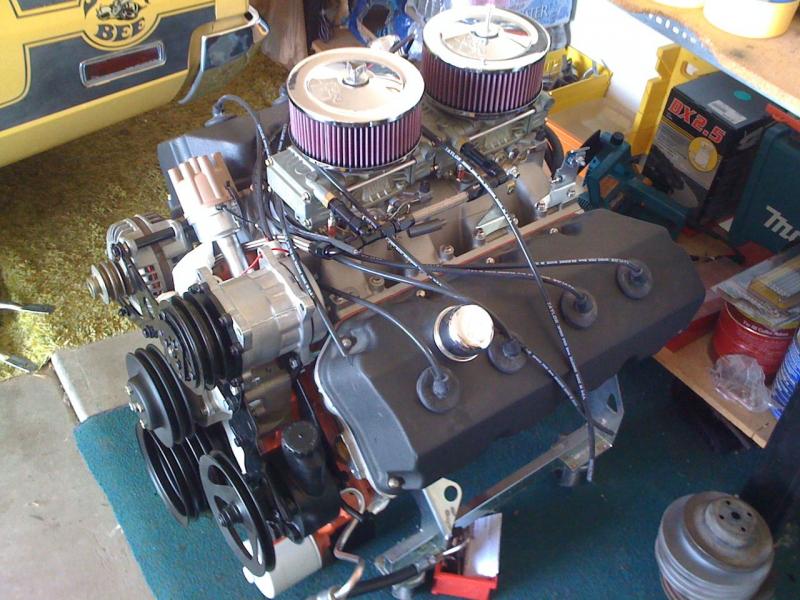

Totally stock 1970 Hemi, automatic cam w/ their headers.
I "HAD" the dual Holly short bowl MOD on then with the Hansen Satage V manifold (still on but now have the Edelbrocks for the Hemi style air-cleaner assembly from "For Hemis Only"
BTW: This WAS Bob Mazolinni's personal "STOCK" 1970 Hemi (automatic cam-short block)
HP: 457Torque: I think...452Again, a "stock" 1970 Hemi short block, stock cam.
NOTE: The Holley's w/ "short-bowl" MOD
Not on car now.
