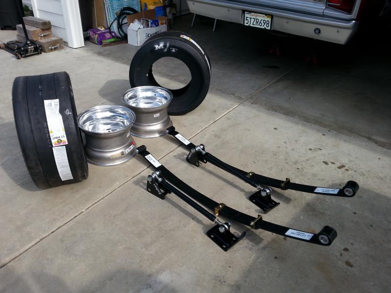

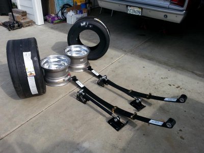

CalTracs.jpgStagng Lane.jpgRon, My life will be complete when I get my new stroker motor in my Coronet and pull the left front wheel on the launch like you do. My new 512" motor is being built to my specs to be right at 600HP and 650FTLBS of Torque. I don't really want more because I want to take it easy on my trans and my 8 3/4 rear end. I just installed a complete CAL TRAC system with MonoLeaf springs/Traction Bar Setup and their 90/10 front shocks and their rear shocks. I also just put on a brand new set of M/T ET DOT slicks 28x13.50x11.25 wide and have them screwed to my Weld Wheels. I plan on running 12-13 lbs. I am hoping for 10.70's.

Wow that Cal Trac setup looks real nice. And so do the tires. I figure I make right about 600 flywheel hp by my et , mph and weight of the car. Thats about what the calculator said I used to run 10.70's at almost 125 at just over 3700 lbs. Good luck with the 512 as you will love the torque it makes as it will plant you back in the seat very nicely ! Ron
View attachment 247419View attachment 247420Ron, My life will be complete when I get my new stroker motor in my Coronet and pull the left front wheel on the launch like you do. My new 512" motor is being built to my specs to be right at 600HP and 650FTLBS of Torque. I don't really want more because I want to take it easy on my trans and my 8 3/4 rear end. I just installed a complete CAL TRAC system with MonoLeaf springs/Traction Bar Setup and their 90/10 front shocks and their rear shocks. I also just put on a brand new set of M/T ET DOT slicks 28x13.50x11.25 wide and have them screwed to my Weld Wheels. I plan on running 12-13 lbs. I am hoping for 10.70's.

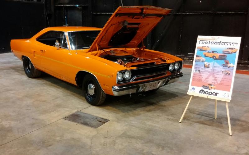

You say you used Cal Trac shocks both front and rear? 90/10 front and 50/50 rear correct? My car is primarily a street machine, I am not going to set it up as a full race car. I have cal tracs with the super stock springs to try and help launch my 542....BTW, all off you have awesome cars, thanks for your input!
I placed 2nd last weekend at the Summit Piston Powered Autorama Show at the Cleveland IX Center. I was in the Conservative Hardtop 70-79 Class.

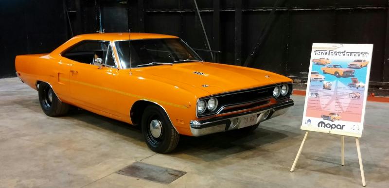

Talking about awesome cars that 70 Roadrunner you have is as or is more awesome then mine is thats for sure ! I love the 70 Runners and thats a beauty you have there. Have you raced it yet with the 542 beast in it yet ?? My 63 is a streetcar also that gets raced once or twice a year when I can. I built it with good quench in the eng as I wanted to be able to drive it anywhere and get pump gas anywhere I went with it. I do agree with you as these guys on here have some awesome Mopars including that fine Roadrunner of yours ! Ron
