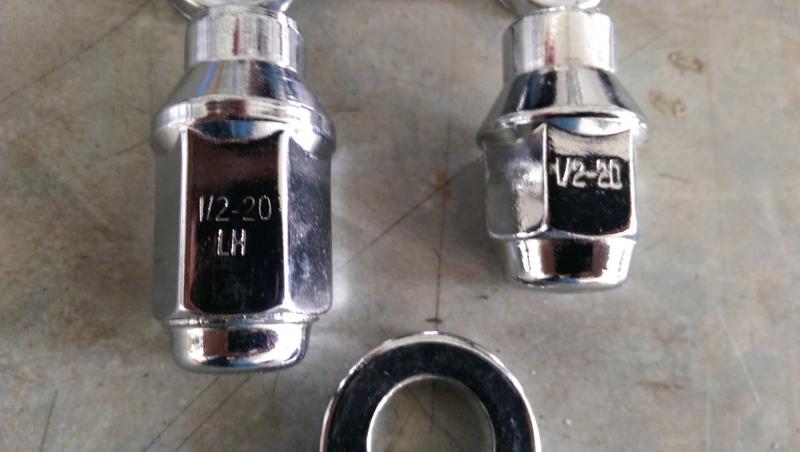

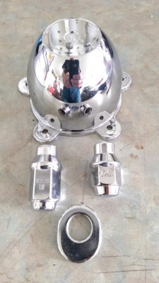

I picked up a set of vintage 5-spoke ET's at the Pate Swap Meet at Texas Motor Speedway this spring. It's a huge swap meet, and there are many new-product vendors in addition to the swap vendors. After buying the wheels, I swung by a wheel vendor and bought all-new special lug nuts (LH and RH), offset washers, and center caps w/screws. I'll dig out the lugs and shoot a photo; they are unique to ET wheels. I'll also see if I can find the receipt with the vendor address. If memory serves, they are from out west somewhere (Nevada, Utah, etc?).

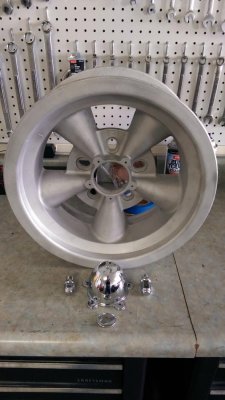

Here are photos of my swap meet E-T wheels (at least the one I have bead blasted so far), and an example of the center cap, LH and RH lug nuts, and uni-lug washers I picked up from the wheel vendor. Unfortunately, I didn't have a receipt in the box from where I bought them. If I remember, or run across the receipt, I'll post it up here. In the meantime, I hope the photos help.

Ok ,thanks everyone,looks like it,s not that big of a deal to get some lugs,I thought for sure would be a pain just like everything thing else is for a 67 belverdere.
On uni-lugs, it is not a problem to get the nuts. It is on the washers. You do know that the uni-lugs are very rough on the life span of the wheel studs, correct? It was very common for me to replace broken studs from the rear axles and I carried replacement parts in my toolbox in the car. Bad thing with snapping studs was loosing the uni-lug washers and cutting the evening short.
