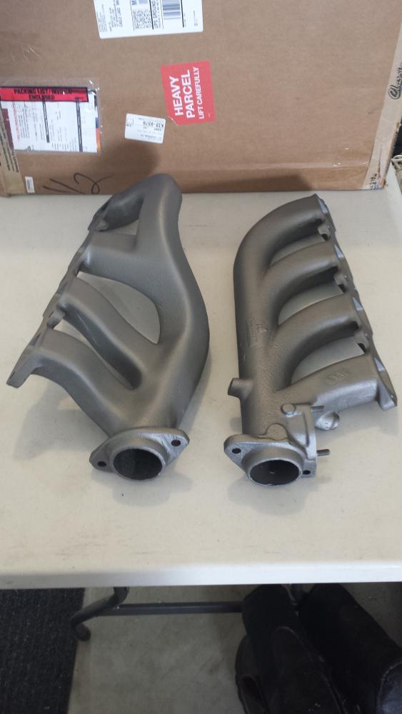

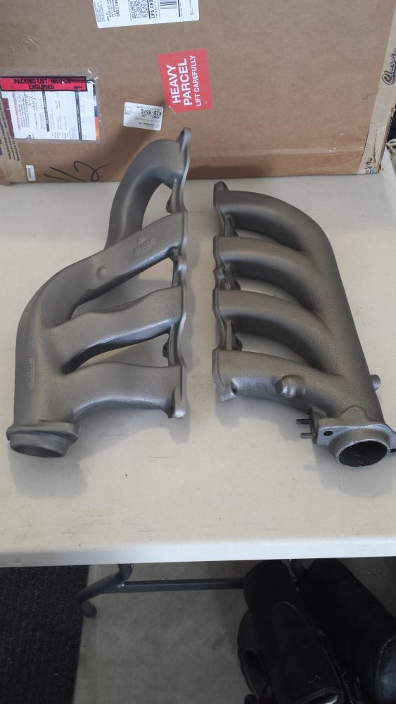

Cerakote Coating
Just picked up my Hemi Manifolds from Extreme Powder Coating in Blooming Prairie MN. Went with cast iron Ceramic finish (inside and out) by Cerakote Ceramic Coatings, they are rated up to 1800 degrees and are warrantied to 1300 degrees. Cost me $187.03 which I thought was ok. Hemi manifolds 002.jpgHemi manifolds 003.jpg

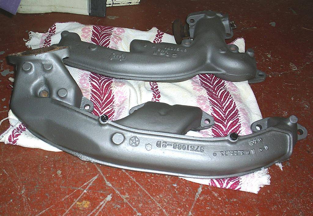

Did mine with cast blast.
These are from the 73 but I did my 67's on the car back in 06 and they still look great.
images
ODZKing, damn those look good. I thought a guy would have to repaint every year for that look (which I wanted to avoid) but yours prove that wrong - nice job.
