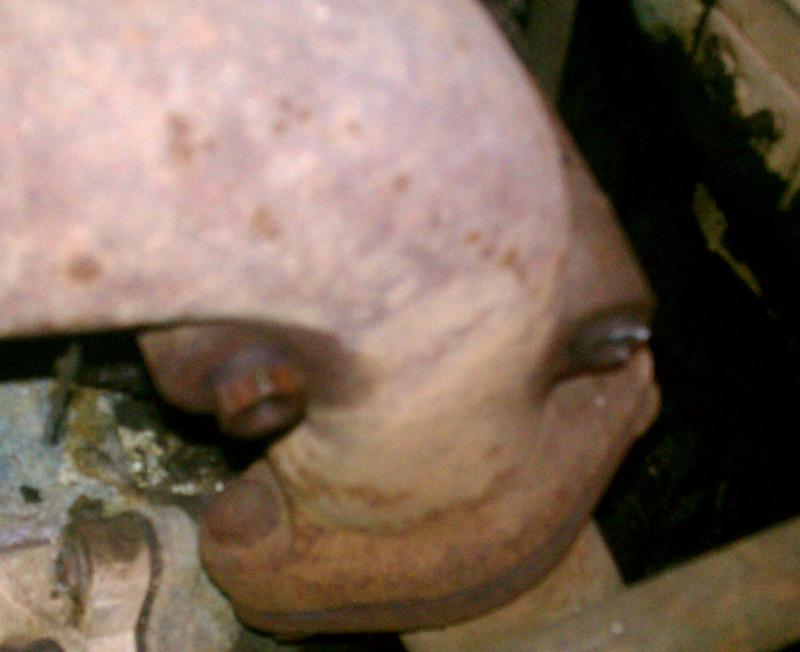

Is there any way to keep from breaking off the threaded sleeves on a big block exhaust manifold? I have been using penetrating oil for a couple of days and even tapped on the outside of the casting. Worked the first one back and forth a little and " snap"!
Looks like I'll have to get out the "easy outs" on that one. I never had this problem in the past. Now I'm a little " gun shy" on the rest. Any suggestions?
