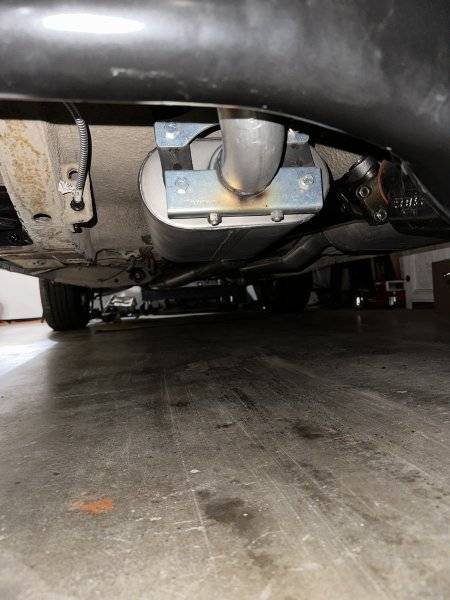

After having resonators for the first time in an old mopar, I will never ever run one again without them. I’d look up that flow chart that is floating around the web, including in my exhaust post. I went with the super turbos as those have a great flow rate. I’ve had them before and had drone, like always. No matter what, I’ve had to deal with drone with every muffler I’ve had behind a big block, which is quite a few different ones.
I would look at ultraflows and add a resonator. The Vibrant can version fit and worked well on my GTX. I have zero drone for first time in thirty years of fooling with these cars.
