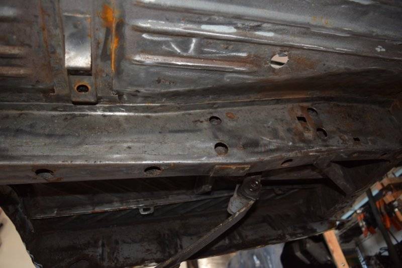

I have great photos of everything but what you need...... This is the best.. You can see the captured nut, sort of. It is clear it is not a clip-nut...

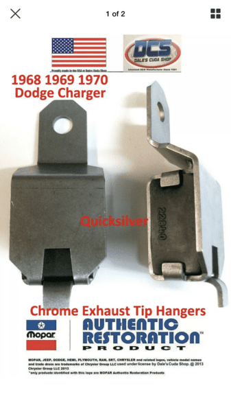

This is what came with my TTI exhaust system. I see they have nuts but I don't remember how they get installed.
Yeah, ok. That appears to be what I thought. It looks like a speed nut that is clipped on to the side of your frame.

There are nuts welded inside the frame rails to attach the bracket bolts. The hangers you have and got from TTI are only correct for 68-70 Chargers. I even called TTI and they confirmed my assumption. You can get the correct ones from Mega Parts if you are working on any other 68-70 B body that isn't a Charger.
Standard turn down pipe hanger shown with clip nut attachment. Chrome extension tip hanger welded nut in frame shown aft of it. As Joel points out, those hangers you show are incorrect for a Coronet.

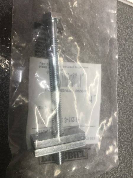

Thank you, mine must have rusted off. I’m guessing they may be inside the frame somewhere. I found something that should work. They are called, draw bolts. Yeah, I found the correct Coronet style hangers.
Thanks, Dad. That’s the best pic I’ve seen. The picture I posted was for reference only. So, the Coronet hangers do in fact mount from the sides of the frame ?

Yeah, I’ve done the same. If it’s possible, you would have to use a washer and a nut inside the frame. The holes are too small to get anything inside them, let alone hold a nut and washer inside the frame, where you need it. Strong magnets work well to hold things in place in these circumstances, until you can start threading a bolt. But, it’s not easy. Problem is all frame holes are way too small to get anything inside. Let alone, hold them where you need them. I think the draw bolt I pictured above will work. Unless, I can find a better substitute. All speed nuts, I’ve found. Don’t center over the hole, after you attach it to frame.
