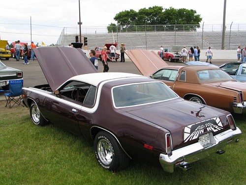

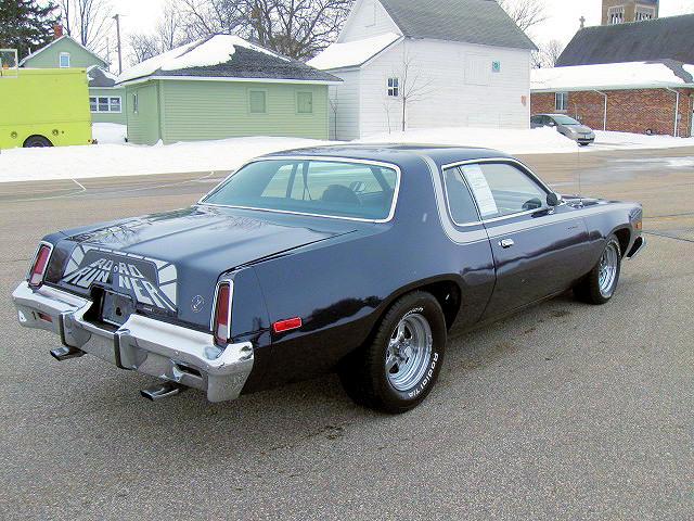

This is the best I can do, and I don't know if they are stock or not?

these are definitly my favorite of the forgotten Generation
i am pretty positive there was no chrome tip option for a 75 runner.i know these pics are the fury lineup, but from everything i have seen and read there is no mention of chrome tips.
