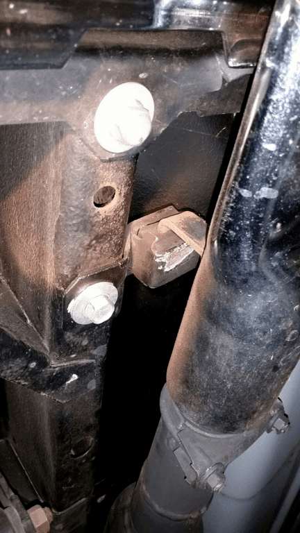

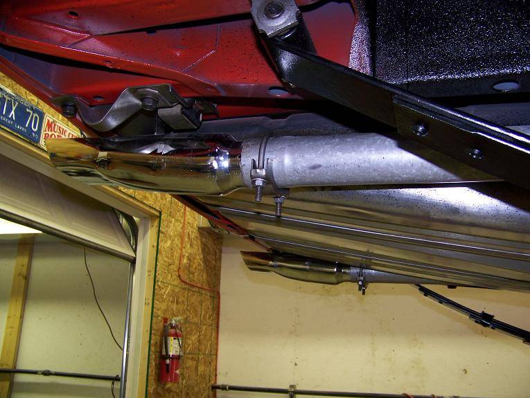

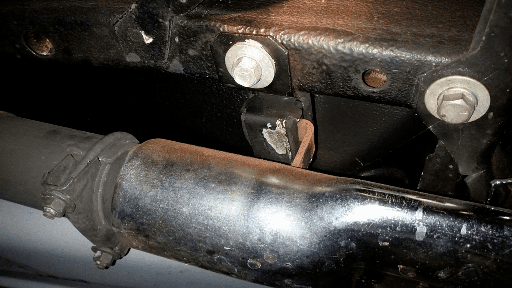

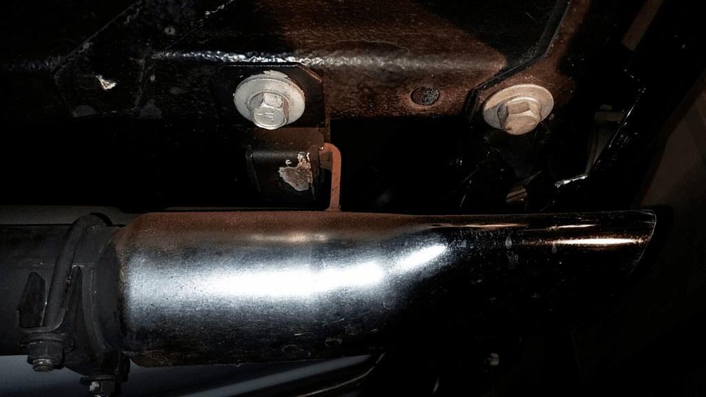

Hi All,
Does anyone have a good pic on how the exhaust tips hang from the rear? Just got a set in and it looks like I need a hanger, which I found some pics of, but I can't work out how they attach to the rear...

First pic taken a few years ago...
These just now...

Lol thanks guys, exactly what I was after. Its for a 68 Coronet, but they are the same part apparently.
Just debating making something, or buying some. They are about $100 delivered to Australia! A bit rude.

Get them. They will sit just right. Mine have never needed an adjustment. Something I always notice is the tips being too low or sticking out too far. Rigged. Detracts from the rest of the car when not right. I got mine from Dodge back in the 80's along with the tips IIRC.
My super bee has the type that bolt into the side of the subframe on the vertical surface vs. the bottom of it like the ones you see in these pics. The ones here are MUCH easier to access.. wonder if i could swap mine out for this style as mine loosen occasionally.
