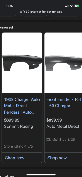

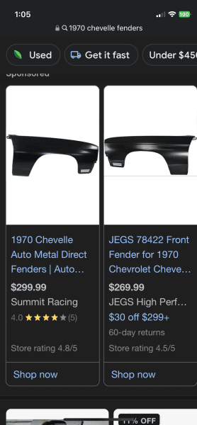

Explain this unfairness.
RXTREME
3:42 PM
Oct 12, 2020
76
42
Houston, Texas
Explain this ridiculousness.

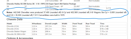

For the record, I see the same thing as you. Chevy parts are always cheaper than our stuff. The reason is because of popularity and production numbers, FAR more Chevelles were built, far more remain to be restored so the market for Chevrolet parts will be bigger. This is basic economics, not anything political.
For example....
442,000 cars? That is over 5 times as many cars versus ours. Sure, that number included station wagons and 4 doors but those are excellent parts donors, right?
It probably costs a similar amount to build a stamping die for a Chevy and a Mopar.
The 'unfairness' kicks in because AMD can probably sell hundreds of times the number of Mopar panels due to the popularity.....hence cost per stamped unit is less for a Chevy.
It's just simple economics of scale.
For example....
If you were to narrow it down, it's 10 times more than a 70 charger.
I think there's a lot of 70 front, 69 rear fenders out there for this reason. You can't buy em at all.
The whole classic car thing is a pain in the ***.
If you compare 69 models of Chevelle and Charger, it is about 4 1/2 to 1.
The 1970 Charger production dropped off to around 45,000 cars partially due to the Challenger pulling some sales from the Charger sales figures.
1970 Chevelle vs Charger would be like you stated, nearly 10 to 1.
