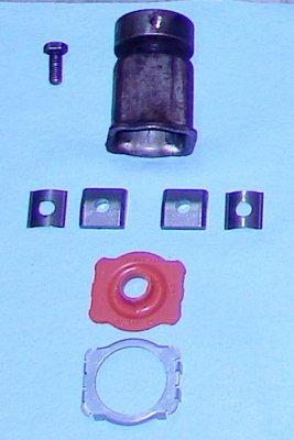

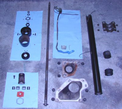

If this helps, I took lots of pictures when I rebuilt mine (65 Satellite column). I was going to write up a 'how to' when I get the time.

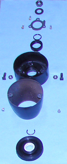

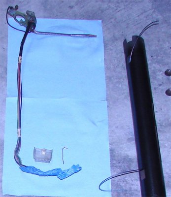

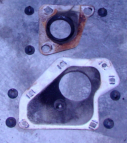

On closer inspection I think I see see what I am missing. In the first pic I see the two sheet metal firewall supports. I am missing the smaller of the two which supports the lower column. Question, is there still in inner column bushing or does this small support do the job?
Anyone have this part laying around so I can get rid of the "shakes" thanx, Bob myers
