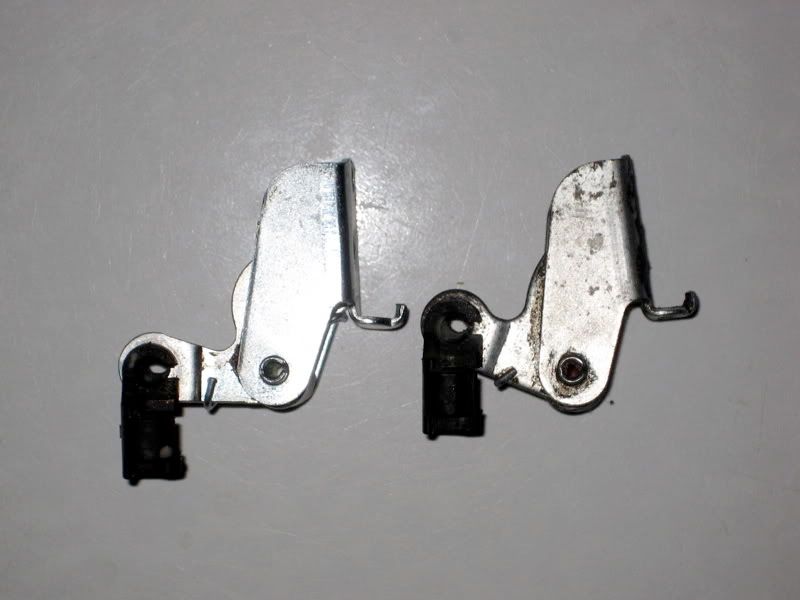

Here's what I found wrong with the new Mopar handles......
The arm where the linkage rod connects on the new mechanism (left) sits lower than the original on the right. This means you have to pull the rod down to clip it in the mechanism. This 1/8" doesn't allow the lock to fully engage and screws up the entire works.
You can either use the originals, which is what I did. Or you can cut off the extra metal on the new ones that pushes the mechanism lower. I don't know if it's the same on all body styles, but at least on my A body, this is what happened.
PLUS, when I went to install the first handle, I realized Mopar had the right mechanism on the left handle and the left mechanism on the right handle.... right out of the box

Good catch :yes:
