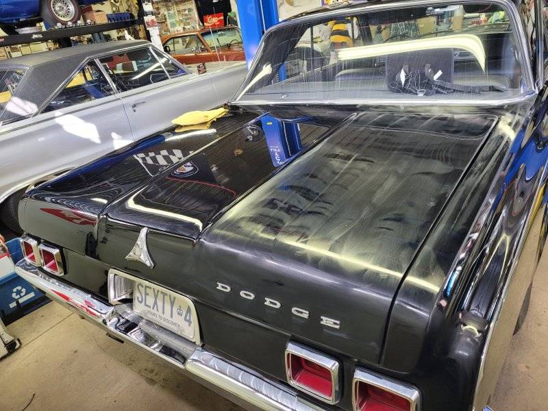

My car is single stage gloss black
We just machined polished it for the 1st time since it was painted almost 25 years ago. It didnt look bad before. But it sure looks dang good now
Im looking for ideas on best protectant / gloss for it.

i would recommend two coats of a good carnauba wax every six months or so. Just wipe the car down with a synthetic detailer in between. I do see less dust on the car since using the quick detailer. And what dust there is comes off with the California car duster with no scratches or smudge marks.
I agree with the good wax on a single stage. Gives it a nice protective coat
Bill, I have 2 black cars and I use the California duster. It’s treated and picks up the dust rather than just pushing it around.
Maguire Gold. I dust all of mine with a California Duster. No covers..
And this car has a quick shat 15+ year old scuff and paint on it.
I use a “butter” wax. Forget the brand. Chemical guys I believe. I have to use a cover for damage protection. I use quick detailer and a California duster as needed. I do think it looks better when using a dedicated rag from the detail products people. Microfiber generic stuff just didn’t do it right.
My detailer said if it’s not birdshit, let it go til next wash. A asked WHY. He said “you’ll scratch it. I follow the advice.
