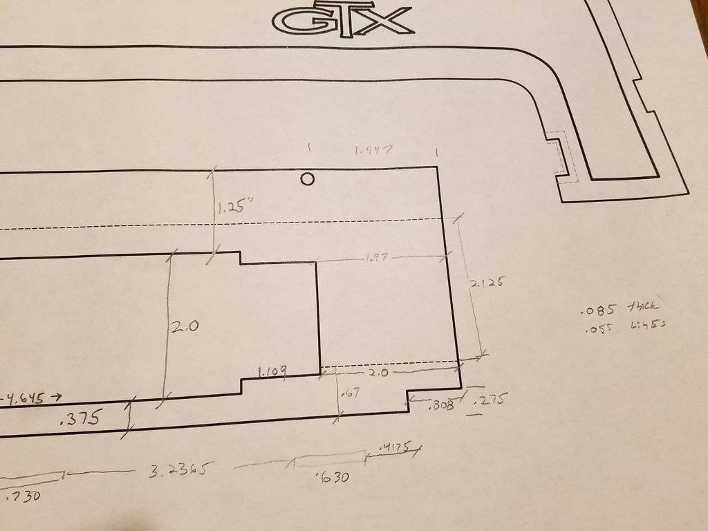

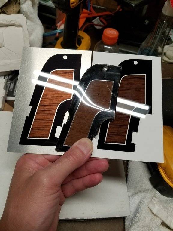

After 3 longs months, hours on Autocad, hours and hours on Photoshop, test prints after test prints sent to print houses, laser cutting, water jetting and CNC machining, tests with Lexan and acrylic, casting molds, and trying drape thermo-forming, it all comes down to this choice.
These are dye sublimated high gloss aluminum sheets, water proof, scratch resistant, fade resistant, and just downright durable as hell. No peeling bubbly decals over plastic here. These will last forever.
The issue is the chrome pin striping. There is just no easy way to reproduce it. So, that leaves 2 choices:
1) Print to brushed aluminum finish - Left (The chrome areas are brushed Al)
2) Print to white finish - Right (The chrome areas are white)
#1 causes the woodgrain to appear brassy-copper.
#2 the woodgrain appears properly.
Please view the attached pics and videos and voice your opinions.
I will add the proper curvature to the piece to match the original after it is cut to shape.
Nice work....very cool. :thumbsup:
Both look great! I would prefer the silver stripe over the white stripe, even if the wood grain is lighter. I think a lighter color wood grain looks better than the darker too. Nice work!
holy crap! that looks great!! the right one looks more like the original.
if you start producing them, I may take an entire set for my GTX.
Great work indeed! I like them a lot....68 was a lighter woodgrain and 69 was the darker woodgrain...The original you have is a 69 piece....So both you have made are correct for those years....
I am sure mine are 68 due to the radio faceplate having no labels. In my research I have found so many variations in both color and woodgraininess from set to set. 69s tend to have a slightly darker "redder" hue to them. Also the woodgrain tends to look more realistic. Some of the 68s I've seen don't look like wood at all. I am lucky as I have a set to use as a target.

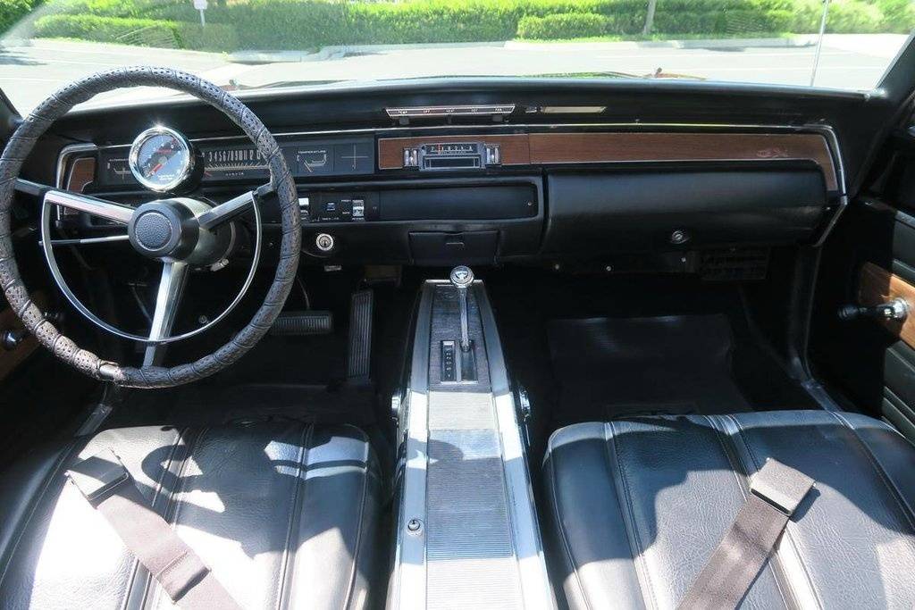

I think it would look better without the chrome/white pinstriped; just woodgrain and black. That would be way better than anything I've seen. My car is not a numbers matching original. So, I just care about the 3 pieces matching the other woodgrain in the car (door panels and console).
Here's an example of a 1969 Coronet R/T dash. The woodgrain looks quite a bit darker in person. I guess the digital camera flash makes it appear lighter.
That console woodgrain in the photo (2013) was replaced this spring.

They both look great. Are you laying down the black base on both prior to the woodgrain? Curious why the white base would look darker as a finished product.
"The image is first printed onto a transfer paper and then is adhered to pretreated aluminum.
The aluminum and transfer paper are placed into a custom heat press, which is heated to temperatures exceeding 380 degrees Fahrenheit. While being subjected to extreme heat and pressure, the dyes from the transfer paper turn into a gas, are pressed into the surface of the metal, and then solidify into the treated aluminum. As the dyes cool they are permanently infused beneath the surface of the metal substrate."
http://www.blazing.com/metal-prints.html
BTW...I do not use this company but there is a lot of info there.
I think it is because the metal finish reflects more light back to your eye than the white finish does.
