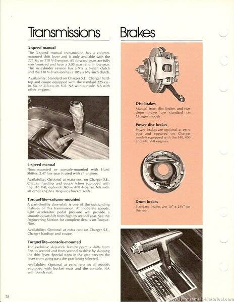

I also thought 400 was largest to get a 4 speed? I have a 73 rally u code 440 magnum that is a pistol grip 4 speed but fender tag shows auto.
You are correct in that, 1973 Chargers with 440 engines were automatics only, and the biggest engine available with a manual was the 400. The export question is a good one.

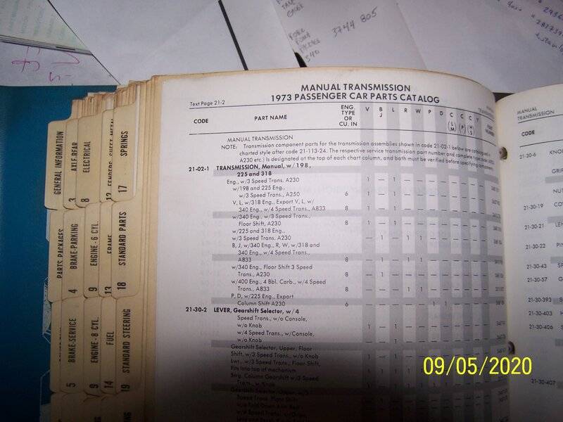

The parts book also shows only the 400 having a 4 speed.
Sorry, you could get a 340 with a 4 speed but not a 440, but then you probably got that.
Ok, yalls paperwork pretty much confirms autos in 440s only for 73. Builderguys parts manual book shows a 225 , coloume shift for exports. Can we conclude IF the 440 manual for exports would prolly be listed there , if that was available ? One thing you guys have taught me was , if you had the right connections, Chrysler would build you just about anything.....
