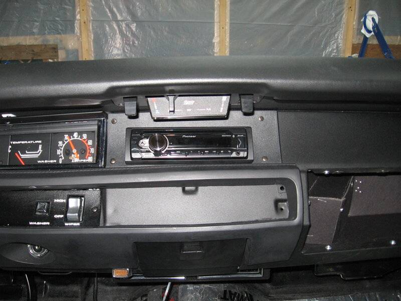

Put classic air in my runner. Vintage air would have had to cut the glove box liner down but not with classic. Simple enough to run lines under hood. Went out where the old ones would have gone. No cable's to mess with for control's. Every thing is electrical servos. Here is a pic of my control and this was a non A/C car. Could not find a non A/C dash pad so have the A/C pad but did not use the opening for the center air vent's will cover that area with a trim plate soon.

Put classic air in my runner. Vintage air would have had to cut the glove box liner down but not with classic. Simple enough to run lines under hood. Went out where the old ones would have gone. No cable's to mess with for control's. Every thing is electrical servos. Here is a pic of my control and this was a non A/C car. Could not find a non A/C dash pad so have the A/C pad but did not use the opening for the center air vent's will cover that area with a trim plate soon. View attachment 1116017

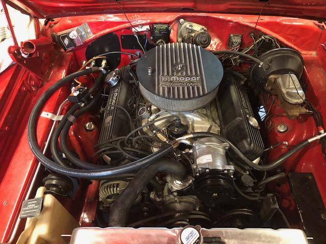

This is my setup from Classic Auto Air. The compressor is in the stock location, the A/C pulleys fit and work like stock.
The routing of the lines can me changed to suit the application. I ran my liquid line from the compressor to the condenser a bit different than they suggested, same with the line from the condenser to the evaporator.
