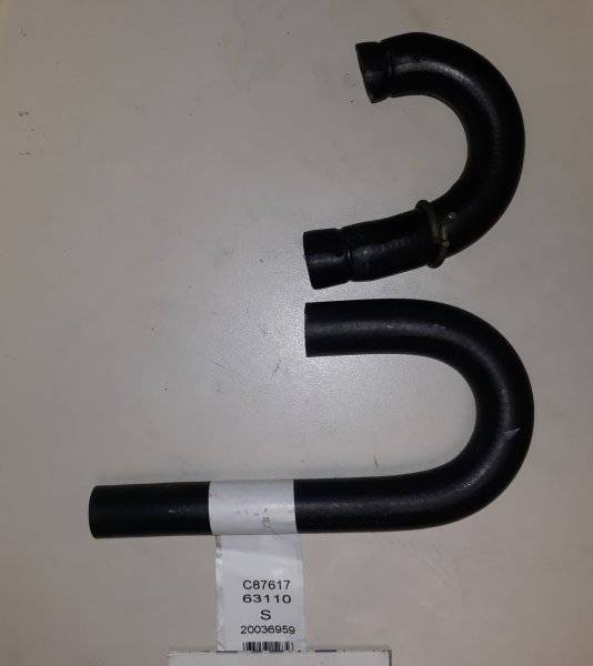

Just hit my local autoparts store.
Had them match it up to my original hose.
Came up with continental C87617
Trim it down a tad and it will work perfectly.
Thanks, I just tried this at local Napa, they didn’t have anything that would trim down.
C87617
My local O'Reilly's let's me go back and match hoses and belts up. The manager there is great.
Thanks for posting this. Much better than paying some vendors $50-$60 for a hose.
Thats basically what I did at Autozone today.
I didnt take the old one with me so we just walked down the hose isle till I found something that looked close . So i grabbed the best one that looked right to me and Sure enough this one is a near perfect shape and size. For under $20 .
Sure beats trying to wrap a standard 5/8 heater hose in such a tight bend
I'll have it on the car tonite as Im working on getting the ac back in operation asap
