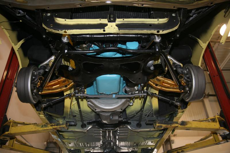

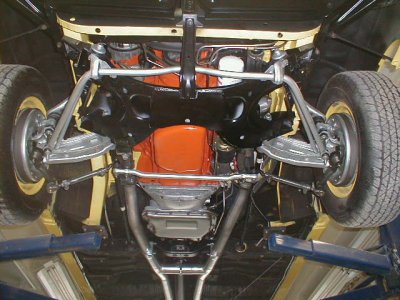

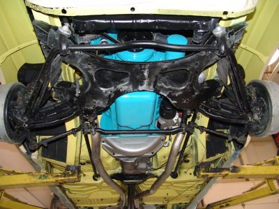

Here's a graphical depiction in 1/24 scale LOL
and some actual shots
Glad to help out. Post some pics up once you're done and and update on your final choices .. may help someone else out too
