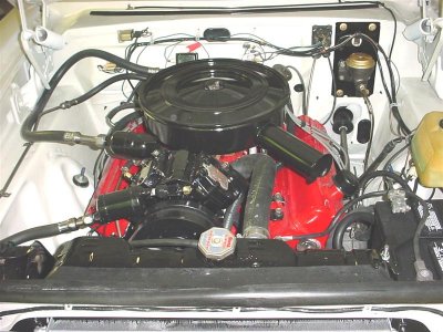

Here is a link to a company that will supply auto paint by code in a 12 oz. aerosol can. All you need is the year of your car and the paint code. I used two cans to refinish the engine compartment in my 65 Coronet. Looks great.

I used two cans from automotive touch-up to respray my engine compartment and then a clearcoat using duplicolor crystal clear. It's just about a perfect match.
