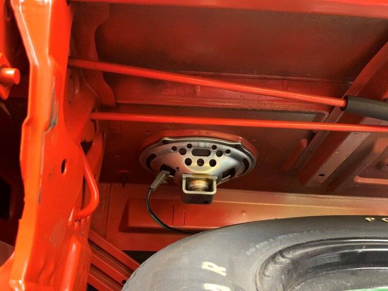

I assume your year is the same...here's a survivor 71 GTX. Notice the speaker is mounted from below.

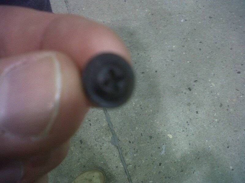

old picture, don't have one on hand now. no separate washer, the shoulder is part of the screw
It looks like the same type of screw GM used to mount the inner door handle bezels on 2nd gen Camaros and Firebirds.
