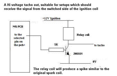

Interfacing factory tach to modern digital tach signal
For those of you who would like to run a factory tach taking the digital output from an electronic ignition box (and not from the coil), I came across this simple drawing yesterday.
Unfortunately I have myself bought an interface box from MSD, seems like wasted money now seeing this simple solution.
It just has a "dummy" relay in the circuit, to generate similar ugly overvoltage spikes that the factory ignition coil generates.
I have an MSD on my 66 hemi Charger and the tach doesn't work when plugged into the "tach" port on the MSD. I will try this relay solution or get a tach adapter.
I have a Mopar performance electronic ignition system with the orange box. My tach does not work. I've been told and have read that the mopar setup should not interfere with the tach. So I am guessing i have a loose wire. If you opt for the MSD, you will need to buy an adapter.
It will work with standard electronic ignition where the tach signal comes from the ignition coil negative terminal, but it will not work with a CD type ignition like the MSD where the tach signal comes from the ignition box. The reproduction tach is supposed to work with either type ignition.
