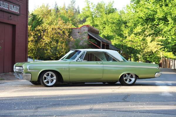

Have you seen my green 64 HEMI Dodge around town?
Not yet, but I like it, I have met Dan 68X426 with the Orange 68 Hemi RR, haven't seen too many Mopars at all.... Here's mine, it's unfinished still, also much more of a beater, not show quality, compared to yours...LOL...
