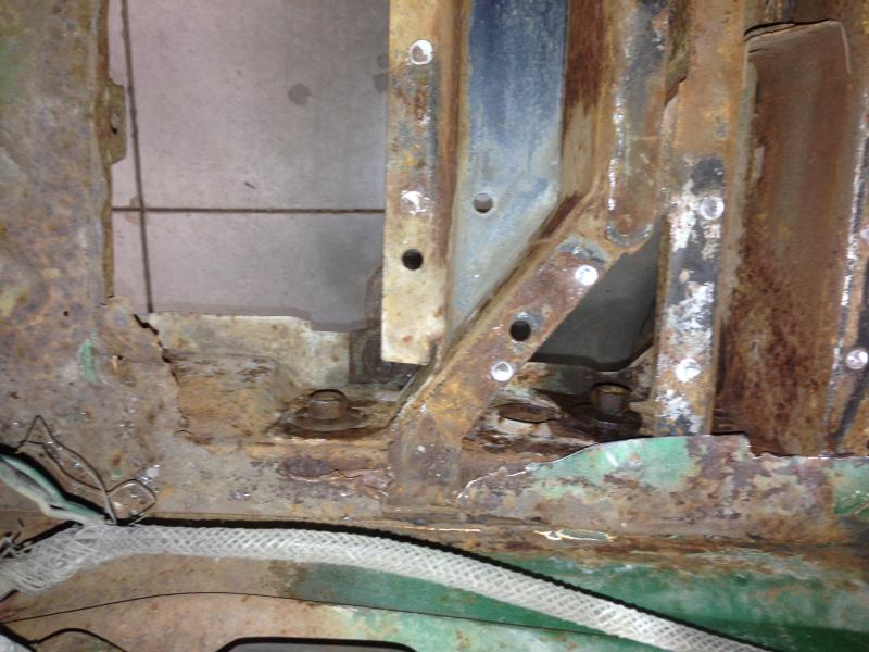

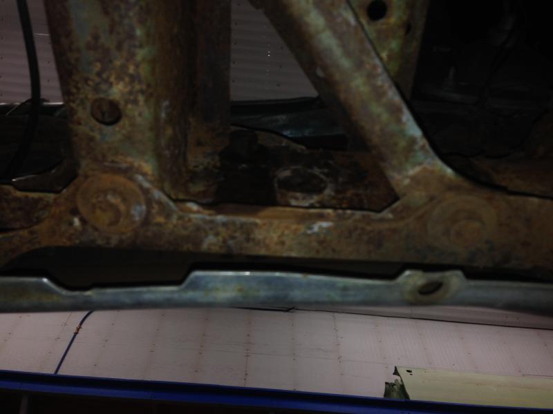

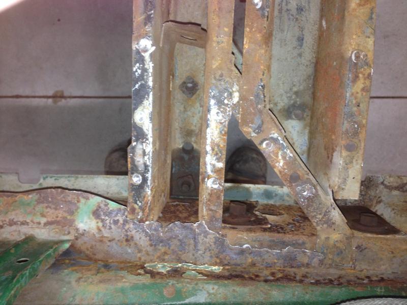

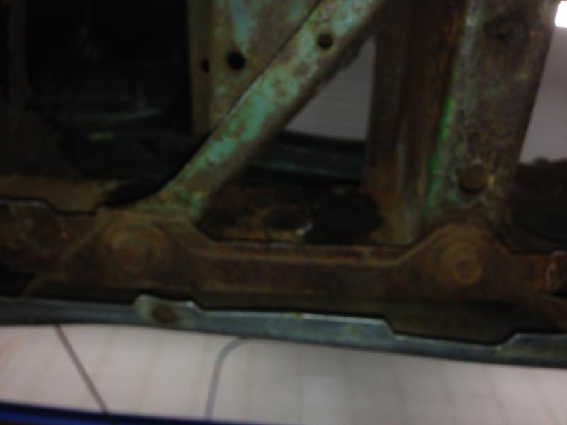

Hey Guys. If any of you happen to be working on your '68-'69 and possibly '70 RR could and your rear bumper is fully mounted, could one of you kindly take a picture of the mounting brackets looking up from the undercarriage? Both sides? My bumper looks fine when looking at it but from the underside the brackets don't look quite right. I suspect missing bolts and such and a guide would be helpful. Thanks in advance.
This on my '69. There are 4 bolts on each side. 2 from the bottom going up and 2 up inside the rails pointing back.
