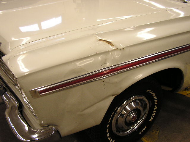

65 Belvedere. Does this look like an amature (being careful) could fix this?
If not....I'll post for replacement (65 Belvedere / Satellite). MInes a wagon, but I guess the front fenders are the same.

Anyways, that fender is pretty mangled. I would try and find a different one, if your just starting out.
If the fender doesn't have any rust on it, it's worth saving. I would fix it, if it was my car or a customer car that I was working on.
Maybe bring it somewhere, to just have it metal straightened, then take over from there. Just a thought.

Can it be fixed?.......Yes. By an amature?.......Probably not. Lotza work! Better off finding a fender in a bit more decent shape Guy..Good luck!
Not worth your time. An experienced guy would write that one off. It's going to be stretched with many high spots. The bottom would make a good patch for a rusty dog leg. It would be easier to cut and weld that part to a rusty fender than fix this one.

You dont have anything to lose, give it a whirl.
first, someone who is experienced could (in time) probably save that fender. But you'd have way more time in that one that buying, replacing, and painting a replacement.

I've been doing this for about 23 years, and if it's a clean fender, it's worth fixing.

Been doing some reading on hammer and dolly work. The large dents are the easy part. Its the sharp creases that pose the problem. I've seen some incredible work. But yours might be on the borderline. Time vs cost. The only one that concerns me is one that crosses the crease on the top, the rest are easy for a good hammer and dolly man. These guys are artists that choose to work with metal!

Save it, looks pretty rust free. Solid metal can always be fixed. Its the front tip that fixing gets real expensive doing. plus these are just not common enough to discard. Plus one often forgets to factor in t he shipping or getting cost in value of a replacement. I say any good fender is worth $200 and up but big sheet metal tends to get local in value.

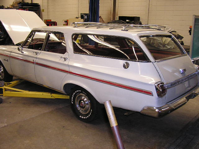

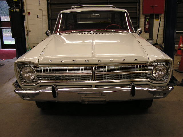

Ok on the carporn request....heres a few.
Nice wagon. As for the fender, find a replacement but keep this one. You wreck another fender this could end up being the good one.
That car is gorgeous!!! Fender, fixable is not rusted out but if it were me I'd replace it and work on the original on the side. Did I say that car is gorgeous. Im a little biased on long roofs though :)
