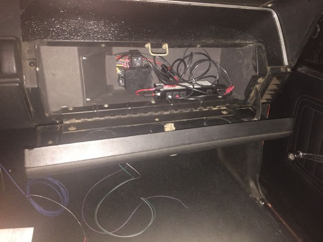

I mounted mine in the glove box and really like it, sit down in the passenger seat and be comfy! I'd steer away from putting it in the engine compartment altogether..... heat, moisture, etc are all bad news and are the reason the engine compartment wiring is always the worst. I'd recommend a universal harness for the job, if your somewhat electrically inclined they're pretty straight forward to install and being universal they're usually cheaper. I think anything other than universal will limit your flexibilty on where you can mount the fuse block? I'm with you, if your going to do it make it easier to get to. Good luck.

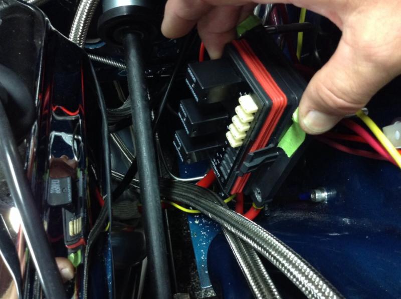

I used this set up on the '64. Can be configured multiple ways to meet you needs. Clean set-up, water proof and reasonably priced! The application is mostly busses and fleet equipment.
Here is the tech sheet and I ordered from Waytechwire.com over the phone using credit card. Super simple!
http://r.search.yahoo.com/_ylt=A0LE...5300.pdf/RK=0/RS=9UpCLv6eJRi98WPbKVEHzyH5KWo-
http://www.forbbodiesonly.com/moparforum/attachment.php?attachmentid=275672&stc=1&d=1441628559
You'll need to order the Delphi wire ends and the wire insulators but they have it all....
