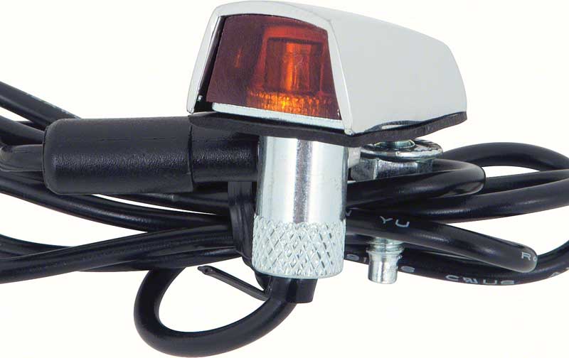

How do you get to the signal housing to change bulb? First Mopar with the signal mounted on fenders.
I know on my 66-300, I have to get to them by the grill. See where you can get your arm to go in that direction. Yours may have to get at from underneath, IDK, got a FSM? That'll tell you!
This shouldn't be any different than the 71-2 Plymouths. If you're referring to the turn signal on top the fender above the wheel ? Just look inside the wheel well above the tire and there it is.
Underside the wire lead goes into the socket. Reach up there and unscrew the socket. May be corroded and give you a fight. Takes a 330 bulb.
When all else fails, I usually resort to a sawzall or a sledge hammer :D
As you can see from the pic, there is a nut that attaches it to the fender. That socket just unscrews but very well could be stuck from the crud under the fender. But here is the pic:
Please spray it with your rust breaker of your choice. They get quite gummed up.
