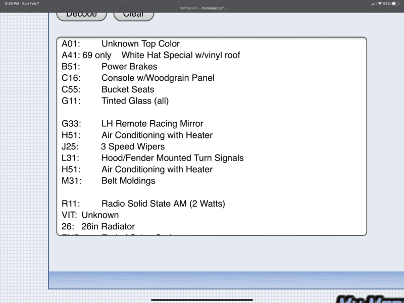

Yep just got it so what does the VIT stand for couldn’t find that ? And unknown top color?why ?
Without looking in my book, I would guess tan vinyl top. V1T, not VIT. Remember you have to start in the lower left corner when entering the codes.
A01 is the light group.
What’s the light group, is that just basic lighting?

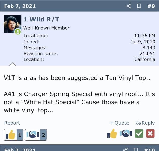

V1T is a as has been suggested a Tan Vinyl Top..

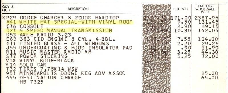

A41 is Charger Spring Special with vinyl roof... It's not a "White Hat Special" Cause those have a white vinyl top...

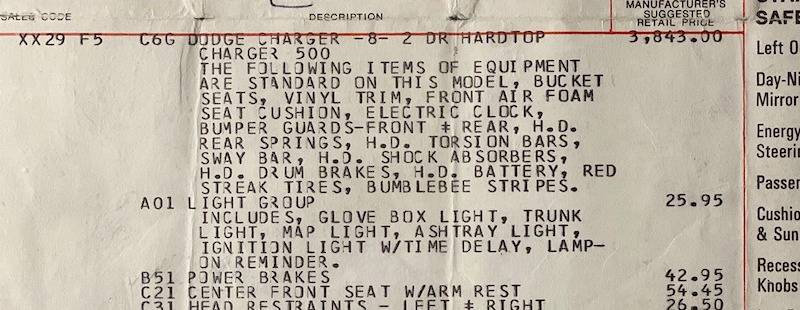

Map light, glovebox lamp, ignition switch lamp. There is some other stuff included as well that I don't remember off the top of my head. I will check in my white book tomorrow if nobody else posts the answer.
A41 with V1X. V1G also available under A41.
