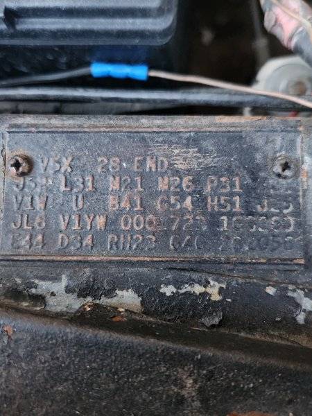

Looking to decode the fender tag on my 74 Plymouth Satellite Sebring, looked on Google and can't find any sites to accurately decode it.

To be honest I was just messing with you knowing that someone will jump in and do it, however almost all of the codes span many years meaning you don't need a specific 74 decoder for the vast majority of codes.
As an example E44 is a 318 and D34 is a std duty auto trans. These codes have been the same for a long time as has many of the others. Point being that you can effectively decode the tag without a "decoder" and I know that most if not all of the codes are on line.

Bottom row:
E44: 318-2V
D34: TorqueFlite automatic transmission
R - Plymouth Satellite, Sebring ("B" body)
H - High (price class)
23 - 2 door hardtop
G - 318 1-2BBL 8 Cylinder "LA" engine
4 - 1974 (model year)
G - St. Louis, Missouri
Six digits sequence number

No unfortunately I think it was removed long before i owned it, the original owner custom ordered it which is why it is so highly optioned

It did help for some of the codes, but for the couple of v codes and the JL6 code I couldn't find anything for them
Some of them I know off the top of my head.......H51 is air conditioning, U is USA spec, 28 is 28" radiator, P31 is power windows, and L31 is fender mounted turn signals. M21 and M26 will be fender and body moldings, V1W is a white viny top. The V5X will be a black body molding of some kind. JL6 is Aztec gold.....had to look that one up.
JL6: Aztec Gold Poly, but I need to verify

What is the J codes (2 digits) on the 4th line from the bottom?
Thank you very much the those v codes were very confusing, I was confused about the U and the 28 as well, the second to last row was pretty confusing tbh

V1YWTrim Grade/Style/Color
V = V Class
1 = Cloth and Vinyl Bench
Y = Gold
000Upper Door Frame: Full Door Panel
723Date Built: 7 / 23 / 1974
163260Order Number: 163260
V1WRoof Type OR Color: Full Vinyl Top - White
UBuilt to Specifications for USA Order
B41Front Disc Brakes Some Yrs. Power
G54Left Hand Outside Mirror - Remote / Chrome
H51Single Air /w Heater
J253 Speed Variable Wipers
J52Inside Hood Release
L31Hood / Fender Mount Turn Signal
M21Roof Drip Rail Moldings
M26Wheel Lip Molding
P31Power Windows
R21Solid State AM / FM
V5XBlack - Mouldings - Protective Insert Body Side
