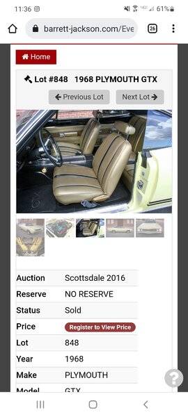

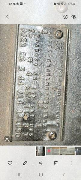

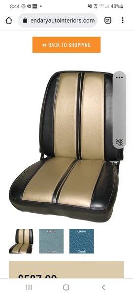

Ok, so I needed to order some seat covers but not sure what the origanal color is. Want to put the car back to what it was like. Black on gold vs. Gold on black interior. May need help on the whole tag. Please help. Is this the correct seat colors?

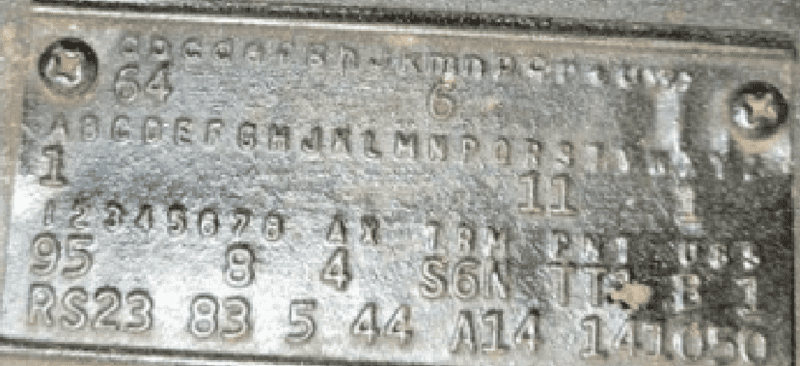

This is the best I can do I’m no good at 68’ fender tags.
CAR: Plymouth GTX 2 Door Hardtop
ENGINE: 440cid 4-bbl HP V8
TRANSMISSION: 3-Speed Automatic
TIRES: F70x14 Red Sidewall, Steel Belted
MODEL YEAR: 1968
BUILD DATE: October 14.
AXLE: Unknown Axle Code
INTERIOR: Sport Trim Grade, Vinyl Bucket Seats. Gold on Black Interior.
PAINT: Medium Green Metallic (Dodge), Avocado Green Metallic (Plymouth), Meadow Green Metallic (Chrysler, Imperial).
OTHER: Black (Dodge, Plymouth), Formal Black (Chrysler, Imperial) Upper Door Frame Color. Black Horizontal Sport Stripe.
MOLDINGS:
19: Wide Sill Mouldings
25: Drip Rail Mouldings
68: Unknown Option

Thanks, I ended up with the same. Just trying to find more details on the Interior section of the code.
I think I found the right ones but the only problem is that Legendary says I will not get them till August. Anyone have good source?
