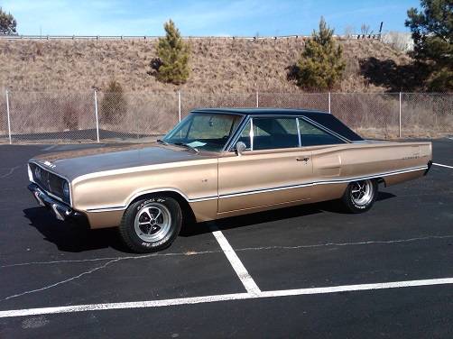

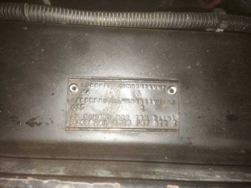

It is my understanding that the BZ2 in the fender tag means it’s a black and gold 2 tone paint job. Feel free to correct me if I’m wrong. I was wondering if anyone has pictures of a 2 tone Coronet. Thanks.
Yes, you are correct. For example if your ordered a gold car for 1968 with a black painted top, the codes under PNT would be BZ2 instead of ZZ1. Broken down that means B= Black Roof, Z= Gold Body, and 2= Two Tone. Without the "two-tone" it would be broken down as Z= Gold Roof, Z=Gold Body, and 1- Mono Tone.
