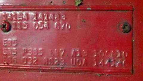

anyone know of a web site that will decode fender tags? or does anyone have any information on codes?
...and the 66-67 Charger registy site has one for those cars that works 90+% for Coronets, Belevederes, satellites as well.
Are the top row of numbers relevant for decoding this fender tag?
Not really.
They are the two digit gate number, the three digit base number and the six digit sequence number. All relate to the production of the body in white.
Lynch Road was the only plant to use that type of layout and info.
