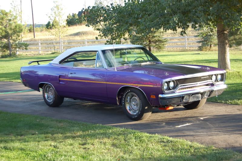

Here is the RR I'm talking about. It always help to have a picture! :)
