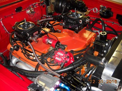

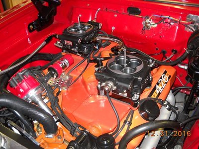

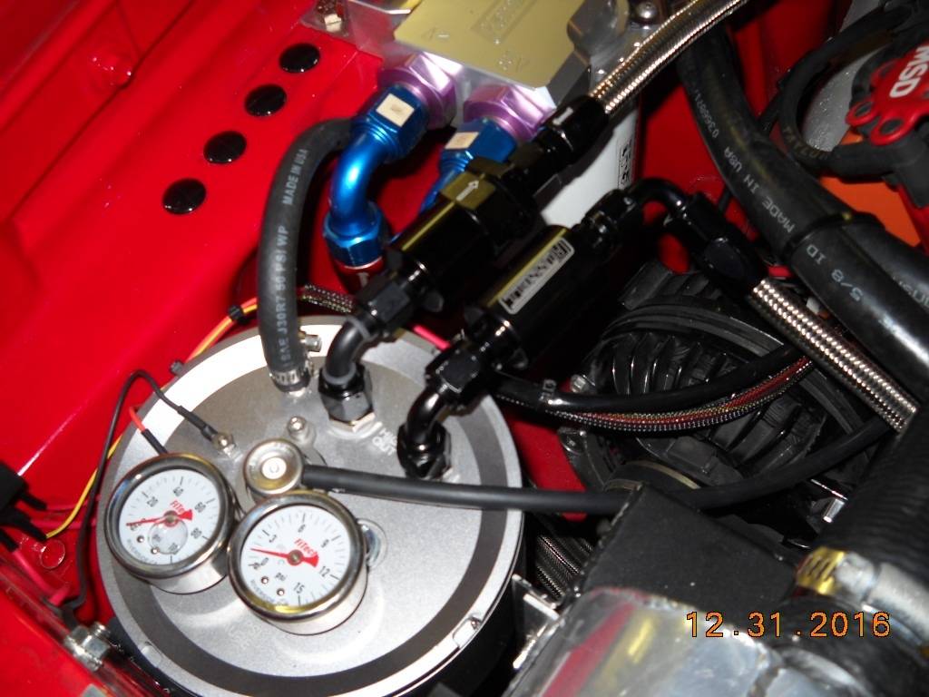

Yes, the FiTech works with 4 speeds, or 5 or 6 speeds for that matter. In my case I use two throttle bodies on a factory crossram, 440 with ported/polished max wedge heads, A833 4 speed, and a 3:91 rear. I originally used FiTech's Fuel Command Center (FCC) and it worked fine. I also use the FI to regulate the timing of my MSD Pro Billet distributor. I am currently having a custom tank built by Ricks Tanks in El Paso (no-one was willing to build one for my 63 until I found them), that will contain an in tank pump and a return system. The tank will be stainless steel and I've re-plumbed all the hoses in Aeroquip -6 PTFE (teflon lined) hose. I will now be able to run gas or E-85. My car is a street machine but I like the option of being able to turn those big M/Ts when I feel like it...
