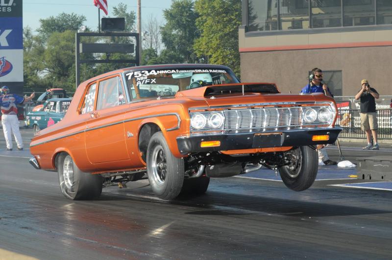

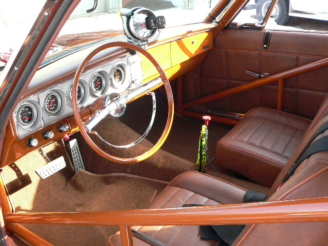

64 Belvedere post: frt bumper 23, rear 25, all bumper brackets frt & rear 26, fully loaded sedan door 75, hood 58, deck lid 58, hood hinges 13. You can get them pretty light and not look cut up if you work at it. Mine is all steel except hood, steel bumpers, doors, deck, mega block, old style wheels, 2 full size batterys. 3110lbs empty.
