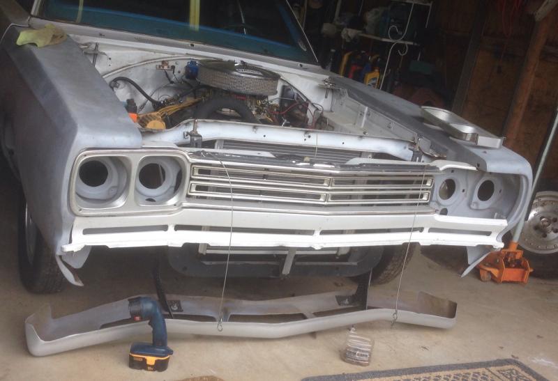

Finally got my glass fenders on my Satellite bracket car. 35 pound weight savings. Every little bit helps

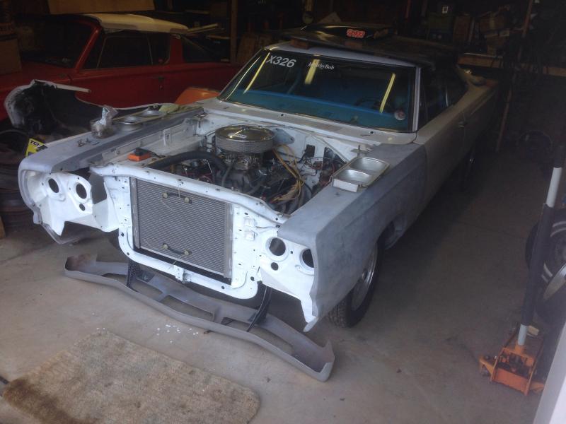

The driver side headlight bezel is fighting me. Looks like I'm going to have to grind/cut away part of the inner edge of the fender so the bezel can fit flush & level. The pass side seemed to fit fairly good when I mocked it up.

Thats something I've always been leery of because of fit issues. Your car is looking good. Who made the parts? How would you rate the quality? How many hours to install? Is this the first time you hung fiberglass? 69 runner right? Cool.

The fit was poor, however it's fiberglass so after several hours of shimming & filling out holes I got the driver side looking very good. The pass side was much eaiser. I don't know who made them. A guy on Facebook in New York advertised them. I msg him if he was comming to NC anytime soon & if so could he bring them. Turns out he was headed to Flordia in a few days so he brought them to me & I paid his asking price for the trouble of bringing them down.

First time I have hung glass fenders. The hood & bumpers are glass. The hood is an old MAS hood. The bumpers are from Unlimited Priducts. Quality is poor on all of as far as fit. Ok for my old bracket car though. I guess I have 6 hours in it so far & thst includes removing the metal fenders
