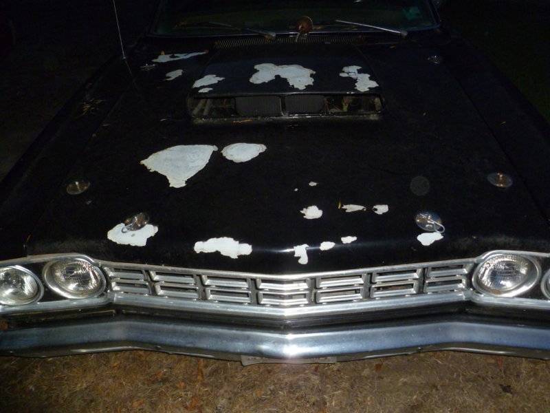

I have a liftoff 6 pack hood from Unlimited on my 68 Sat. Street type hood. Even had provisions for using hinges. The first time I took it to the track , it rolled up the front and cracked the corners. I added a couple of pins in the center and it stopped it from doing it. Just went outside and took a pic to show pin location. Poor ole car is a sad sight. Maybe it will be next on the list for improvements.

The pins need to be further forward. If the under structure is weak it'll need a center pin. I run my AAR hood to 150 on 4 pins without issue. I watched a friends 65 Dodge lift the center of the hood 8"-10"@140+. It got a center pin
