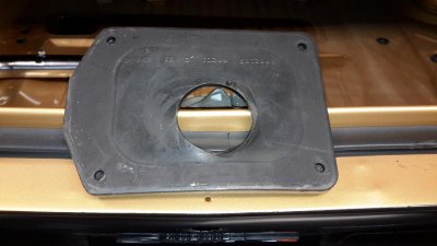

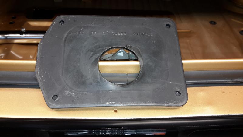

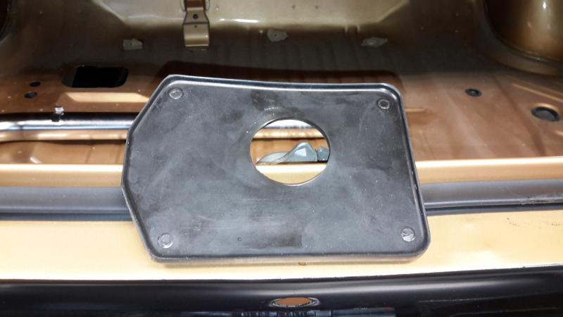

Upside-down? Or the other way?
Other side

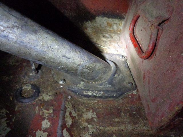

Just curious, does the location of the hole help you figure out which way it should fit?
As an add on to upper post, I removed the filler cap (shove a rag down the tube so the little screws don't fall down the tube) and slide the neck up, insert trunk/filler neck gasket then slid the neck back down into the tank.
